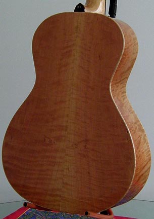

I've built a lot wkith cherry, it is one of my very favorite woods, maybe the best for me. I've always found it to bend easily, and it finishes really good too. Don't try to stain it without sealing it first, or it may get blotchy on you...but under amber shellac it is great stuff.
I'd leave those sides thick. Some builders use double sides, or just thick ones. It won't hurt the tone, maybe it'll help! This picture is kinda dark but you can see how this curly set worked out.
Mark Swanson38898.8989351852

Mark, that is a nice guitar. What finish did you use?

Thanks Hogan, it's just shellac under nitro lacquer.
